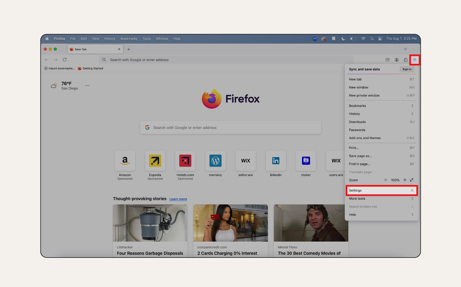

How to clear the cache on Mac Firefox
Now let’s look at how to clear your cache and cookies on Firefox:
1. Open Firefox,  click the Application menu (three horizontal lines), and choose Settings.
A screenshot of Firefox’s Application menu.

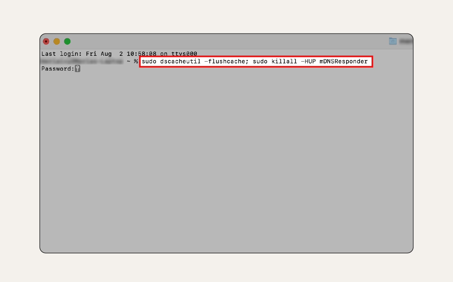

How to clear a Mac DNS cache
The Domain Name System (DNS) cache stores the IP addresses associated with domain names. Clearing the DNS cache can help resolve connection or website display issues.
Here’s how to clear your Mac DNS cache:
1. Open Terminal (Finder > Applications > Utilities > Terminal).
2. Enter sudo dscacheutil -flushcache; sudo killall -HUP mDNSResponder and press Return.
A screenshot of the code you must enter into Terminal to clear the Mac DNS cache.
3. Enter your password and hit Return.
