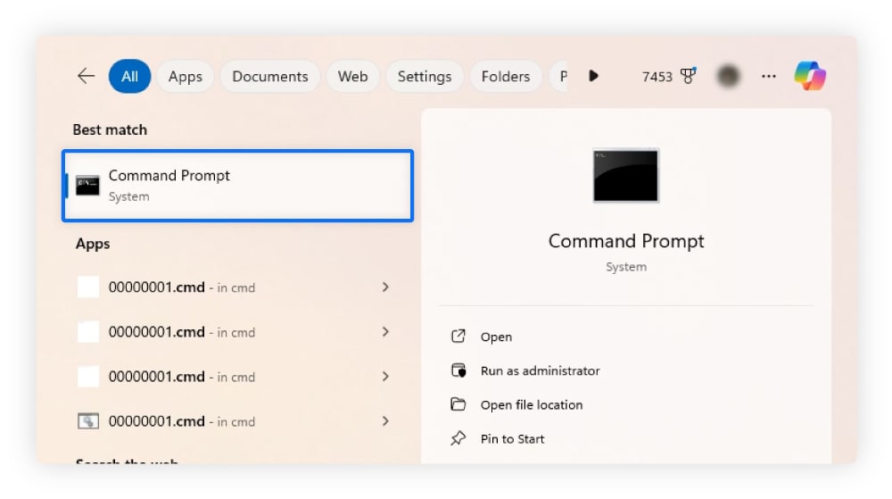

  1. Open the Start menu from the taskbar at the bottom of your Windows desktop.
  2. Type in cmd and click Command Prompt to open the program. Click Run as administrator.
A screenshot of the Windows start menu highlighting where to find Command Prompt.
3. Type in chkdsk and hit Enter to check your hard drive. The system will let you know if it finds any errors, but it won’t fix them unless you enter another command.
